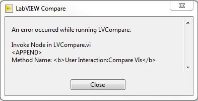

I have just started using version control with Tortoise Git. I changed the Git settings to use LV compare and merge for diff and merge of tortoise git and made a change to a VI after a commit to see the difference. I incur a problem with launching LV compareLV compare error.JPG
 I added .vi extension to advanced diff settings with external program as "C:\Program Files\National Instruments\Shared\LabVIEW Compare\LVCompare.exe" %mine %base -nobdcosm -nobdpos

I tried it with command prompt and the same error recurs
Launching LVCompare.vi  from C:\Program Files\National Instruments\Shared\LabVIEW Compare\supportVIs\_prolvcmp.llb
gives the following error
An error occurred while running LVCompare.
NI_LVConfig.lvlib:Load.vi<ERR>
C:\Users\Z003W3YA\AppData\Local\Temp\LVCompare.ini

I am trying everything to understand the problem. The exe causes error on launch and in command prompt with parameters

When you look at the error, it says it can't opent he ini file for settings.... could permissions on this folder (possibly on a network drive) be part of the problem?

@Kyle97330 wrote:
Did you check to verify that LVcompare works outside of TortoiseGit?
I get that error from an MSYS2 terminal "git diff" with LabVIEW Professional Development System Version 2023 Q3 (32-bit) 23.3.1f1. C:\Users\<user.name>\AppData\Local\Temp\LVCompare.ini does not exist (I have permissions and can create the file manually). The error message can be scrolled down to see the following.
<b>Complete call chain:</b>
NI_LVConfig.lvlib:Open Config Data.vi
LVCompare.vi
