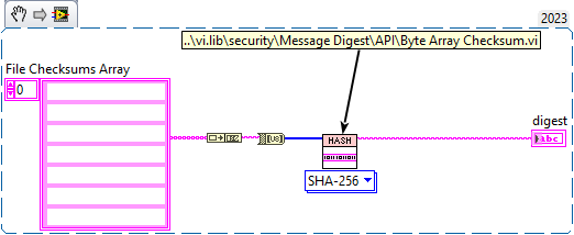

The second option from @tst would look like this. NI doesn't expose the Byte Array Checksum.vi, only the File Checksum.vi. But you can find it in vi.lib.
You already have the array of file checksums and are concatenating it to a single string. Just use String to Byte Array and pass that byte array into Byte Array Checksum.vi
