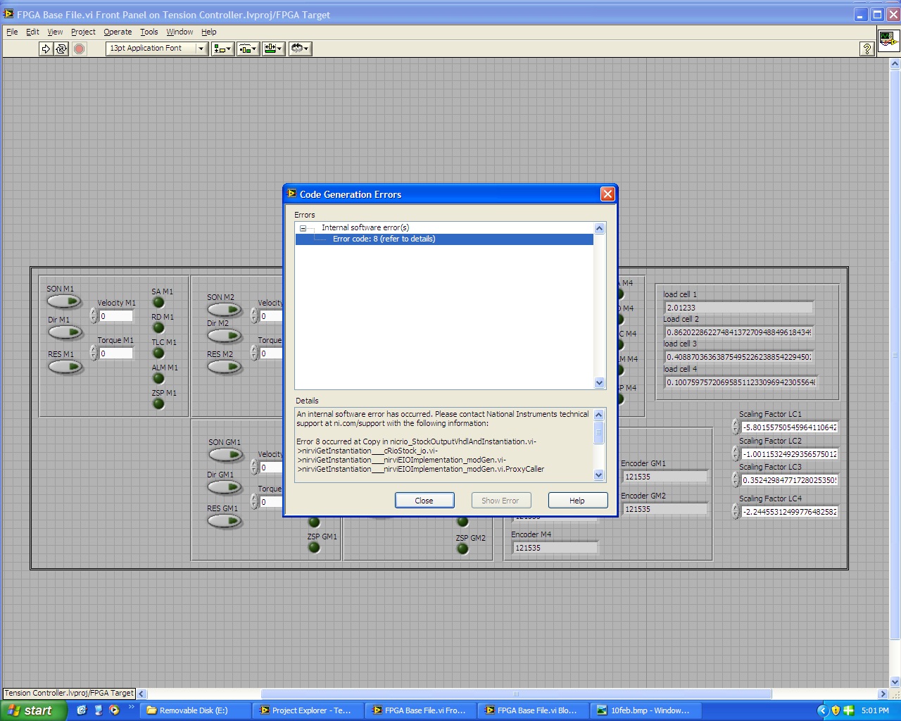

An internal software error has occurred. Error Code 8. LabVIEW: File permission error.
I just changed some contasts to controls in a FPGA base program so it needed to be recompiled.
but it after compiling program showed error.
An internal software error has occurred. Please contact National Instruments technical support at ni.com/support with the following information:
Error 8 occurred at Copy in nicrio_StockOutputVhdlAndInstantiation.vi->nirviGetInstantiation___cRioStock_io.vi->nirviGetInstantiation___nirviEIOImplementation_modGen.vi->nirviGetInstantiation___nirviEIOImplementation_modGen.vi.ProxyCaller
Possible reason(s):
LabVIEW:  File permission error. You do not have the correct permissions for the file.
NI-488:  DMA hardware error detected.
C:\NIFPGA86\clntTmp\TensionCo~65_FPGATarg~A7_FPGABase~A1_eogs1jH0~18\Crio9426IoNode.vhd
Can someone state the reasons for which it is showing an error.
