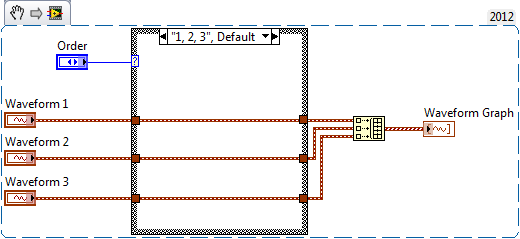

Sorry for what may seem to be a fundamental question: I want to specify where an Analog channel ends up in the data file, column wise. Right now I'm dealing with 4 channels, 0,1,2,3 and the data file acquires them in columns from left to right, 0,1,2,3.
I want to be able to switch 2 and 3 as they are written to the file, using a control on my FP. So..0,1,3,2. I'm using "write to measurements" and my signals are voltages. Any ideas?

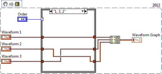

If you have three separate waveforms, you can combine them using Build Array as follows:
If you acquire all waveforms as an N-dimension array (i.e. from the same analogue input task) you can index the array and proceed as above.
Edit - point being, it's the order in which the array of waveforms passed to Write to Measurement File is built that determines the order in which they'll be saved in the output.
CLA
Message 2 of 9
(4,709 Views)
