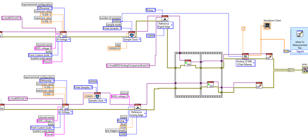

1. I'm not quite understanding you here...  I thought that the 9223 task starts first, so its pretrigger is "armed" and I assume the hardware will sit there and collect data in a buffer.  Then, the 9205 task is armed, and it will trigger upon a certain voltage, which will then trigger the 9223 task.  Shouldn't it not matter how long the 9205 task is running?
2.  Maybe my answer to (1) is crazy....  so, I did what you said and now am using the AnalogComparisonEvent from the 9205 module.  I get data, but it triggers on its own and it doesn't record anything but the baseline noise so it's basically triggering right away.  I get 500,000 samples, as expected, but.... maybe the fact that it is triggering on its own is because the task is ending too soon?
This is my first time using these DAQmx task functions so perhaps I don't know what I'm doing....

Alright, folks.  Progress, but it will only trigger the 9223 immediately - it is not waiting for a threshold... or is it?  I don't understand what is happening.
I attached my code.  I separated the error things so you can see where the error occurs.  I also took out scaling.  I'm doing this as simple as possible to understand the basics here.

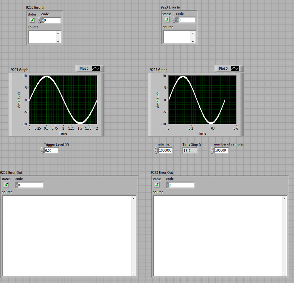

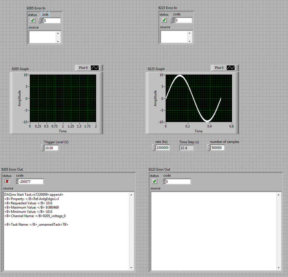

I am running this today with virtual devices - so the "input" signal is just a 10V sine wave from the dummy devices.  Here is the behavior:
when the trigger threshold is "achievable" both trigger right away, regardless of signal.when the trigger threshold is "achievable" both trigger right away, regardless of signal.
When the trigger threshold DOES'T occur, the 9223 triggers anywayWhen the trigger threshold DOES'T occur, the 9223 triggers anyway
So, the 9223 is triggering no mater what.  It's not waiting for the 9205.

The discussion previously (in which it worked "fine") in the thread alluded to putting the cards in the same task and sampling at the same rate (250 kS/s, which is the max rate for the 9205).
My goal is to sample at 1 MS/s with the 9223 but use the 9205 to trigger this acquisition, since the 9205 has hardware triggering capabilities.  I am using chassis 9184.
Doing an analog edge reference trigger with the 9205 and acquiring with the 9223 at 250 kS/s is straight forward.
The latest code I have written is proving troublesome.

I also went back for a closer look at msg #4 code "beta_code_2.vi", now that I'm suspecting that might be the *only* code you posted that uses real physical devices rather than simulated ones.  You posted error text but not the error code #.  What was it?

I would expect it to trigger immediately - sure!  The device is simulated, has no input signal, so the "input voltage" is just an oscillating sine wave.  I was thinking I could "use" that as a virtual test.  But when I put the trigger threshold OVER what that "input voltage" seems to be, the VI gives that error.
I thought I did specify the number of samples to read with the sample clock for each task.
I attached the latest version in which I put some diagnostics (total samples per channel acquired) into the code to start to try to figure out what the heck is going on.  This is a virtualized device VI.
