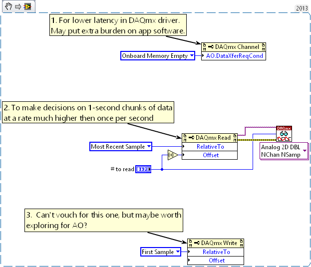

USB is not ideal when your needs are for low latency.  That alone will limit what you can hope to get from a best-case scenario.  That said, here's a snippet illustrating some DAQmx property node settings that may be helpful.
1. There's a property to tell DAQmx when to move data from the PC's RAM over to the daq board.  You get low latency by having both the driver and your app set up to deliver data just-in-time.  If the AO task requests data from RAM only when it's onboard buffer is empty, then the data it gets will be D/A converted pretty much immediately.
   The trick is that you also need to have your application write data to PC RAM just a little at a time, and just barely before the driver needs to move it to the board.  You may find that DAQmx Events or some other DAQmx properties will help get you there.
2. This little trick lets you read from the AI buffer as though it's a sliding window.  You could query it 100 times a second, each time reading the most recent 1.000 second worth of samples.  This lets you make decisions based on a significant quantity of data but keep re-deciding at a high rate.
   Note: this trick doesn't play nicely with data logging as you will read the same data many times.
3. ??? I'm not sure about this one.  But there's a property node that *seems* to suggest you can control where in the buffer you would write your data.  Not sure that most hardware supports this, but hey, it's something else to experiment with.
-Kevin P
