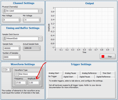

I have a 9263 module to generate an analog output voltage but I would like to increase/decrease the voltage via input on the front panel. I am using the Voltage (non-regeneration) Continuous Output example code in Labview 2019 and set the the sample rate to 400kHz (the max for this module). However, when change the amplitude, the changes on the output channel occur after approx. 10s, which is too slow.

I uploaded a screenshot with the control that I use to increase/decrease the voltage, and also upload the code with the default values I am using.

Thanks.
So, even thought you specify a 400kHz sample rate we can see the readback is only 1000s/Sec. With 8k samples that means the waveform settings are only updated every 8 seconds.  Or pretty much what you originally mentioned.
To update the waveform settings more frequently, reduce the samples per generation.

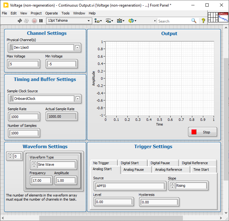

When you run the vi on your real device, what does the 'Actual Sample Rate' say?   I noticed the 1000 Hz in your screenshot too but thought it might just be a default value that didn't get updated.
I tried running with a simulated 9263 and it returned 400 kHz as the actual rate, but also issued a warning for violating the device's capability, which is only 100 kHz according to the spec sheet.
I don't 100% trust the behavior of simulated devices, but it's the closest I'll be able to get.
