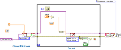

for your first solution I tried it like this:
Is that what you meant?
In any case I still get the error...

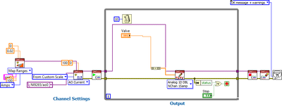

And for your second solution I think it worked!! I did not get any errors.
This is how I did it:

I'm glad the second one worked for you.
The first one should have worked as well.  What error did you get?
Was the value of valve greater than 100?  It is possible that because of resolution errors with the math of floating point numbers 100 x .02 could have wound up being something just slightly larger than .02.   Something that could help prevent an issue is feeding the result of the multiplication through an In Range and Coerce function.
