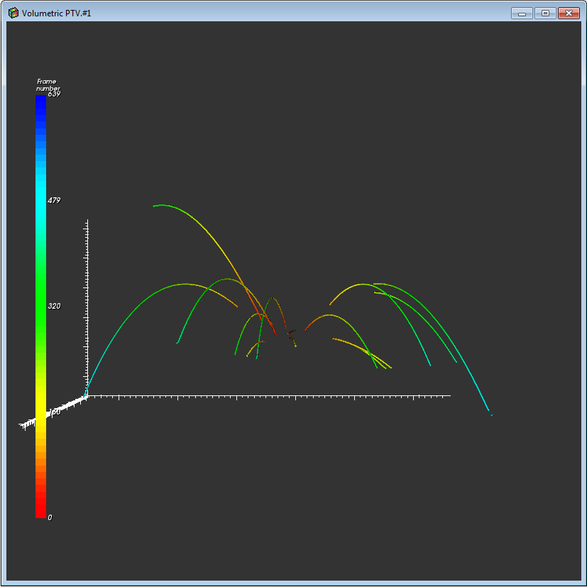

I made a 3D image with particle tracking. There is (in this example) 17 tracks with strating point in 0,0,0 (XYZ). Some of them doesn't have starting part of track (tracking problem), but it doesn't matter.

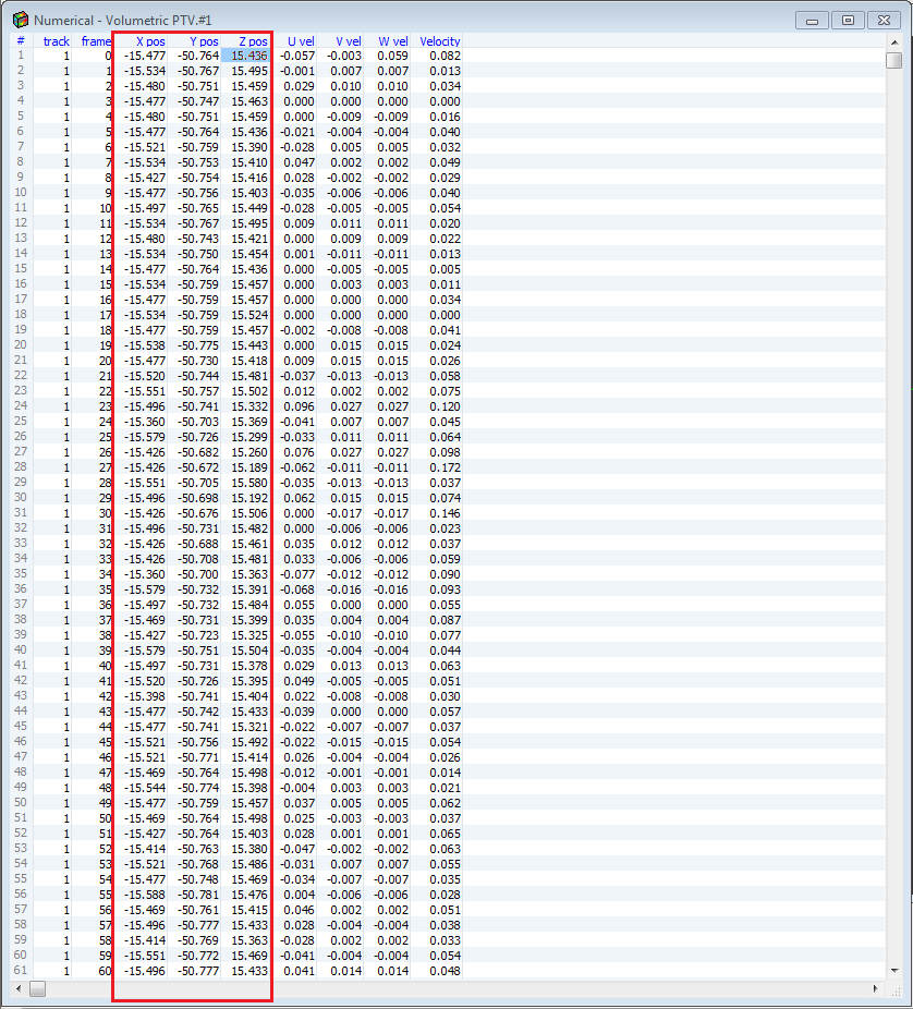

I also have a numerical table with whole XYZ positions for every particle in next frames. Now my question: is there any way in LabView to measure initial (strating) angle for every track from first 10 frames (1-10)? On picture above this could be an angle for part of tracks marked in red colour. We only have to know initial angle, other part of tracks does not matter actually.

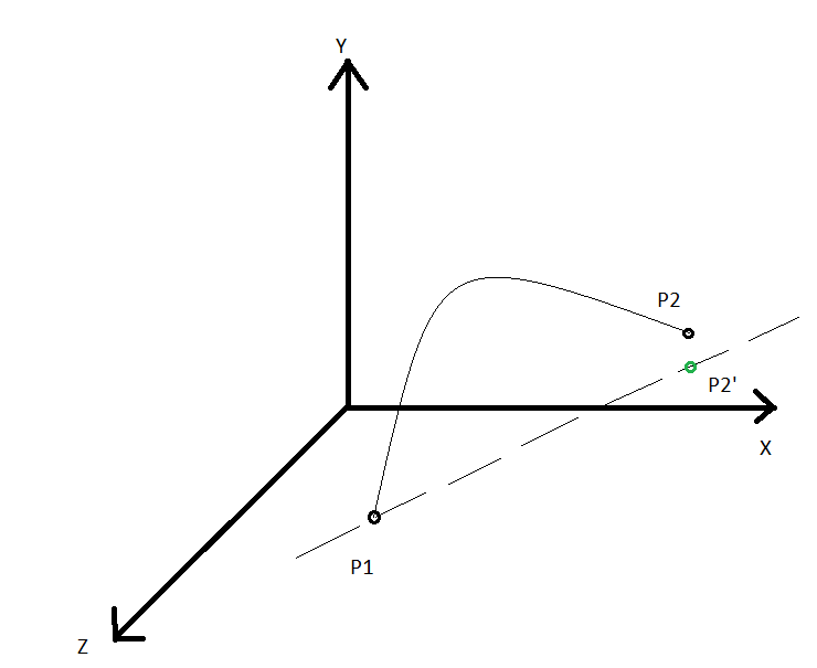

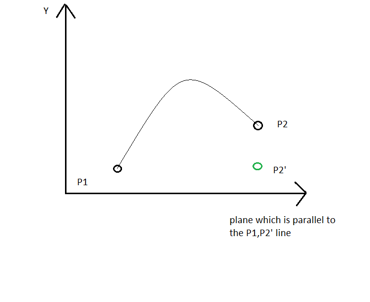

I think that You don't understand me at all. I also thought that were different questions, but I'm not mathematician so I can't explain it. How does look our problem:
We would like to convert our 3D trajectory (XYZ) along its direction to 2D. So we decided that we sholud create new plane. Our plane should be parallel to line between P1 and P2' points. For exmaple: P1 20, 10, 20  ; P2 40, 20, 10 and point P2' is created by projecting P2 on XZ plane with Y coordinate like a P1 point (so P2' 40, 10, 10).
What we would like to get:
What I understand from previous posts is that we can only project our trajectory to XY, XZ or YZ plane. But we would like to get it "flat" on a plane that I described above.
Apologize if You get me wrong or I didn't understand You.
