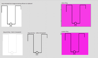

 In the following I set the picture control background to pink

@alexderjuengere wrote:
I am afraid the transperency information is getting lost when copy and pasting the image from image to clipboard to ring control
but the transperency information is preserved when the image is copied via drag and drop onto the frontpanel and from there into the picture ring
white is transperent in picture ring  image  alexderjuengere_1-1695211531997.pngalexderjuengere_1-1695211531997.png
black is transperent inpicture ring image alexderjuengere_2-1695211575030.pngalexderjuengere_2-1695211575030.png
no transperent color in image blacl-white-images alexderjuengere_3-1695211650857.pngalexderjuengere_3-1695211650857.png
I use IrfanView to save the transperent image
