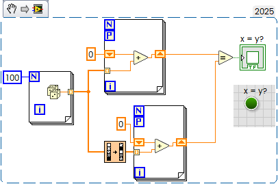

@alexderjuengere wrote:
But when calculating a sum, the order to process iterations is not of concern e.g. 1+2+3 = 1+3+2
In this particular case of integers yes, of course, but in general associativity fails in floating-point arithmetic, it is quite simple to demonstrate:
Message 14 of 23

True, for DBL the order of operations that slightly alter the result, but both results are within the limits if the datatype for typica data. For pathological data, the results can differ dramatically, for example if the first billion elements are 1 and the last is gigantic, reversing the order, the gigantic number will be the result unchanged because x+1=x for all additions..
Note that even for binary identical inputs, the parallel FOR loop might give slightly different results between runs.

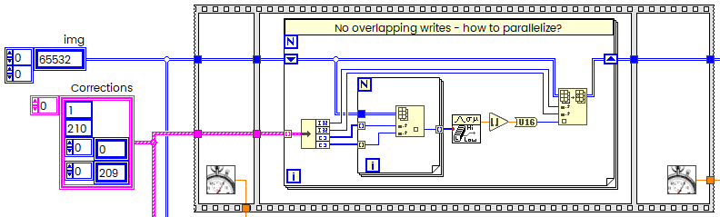

@altenbach wrote:
Unless we gain a factor of two, I always stay with the simplest solution, which in this case is my single parallel FOR loop. 😄

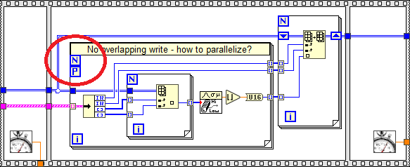

Fully agree. Unfortunately, it's not always easily possible. For example, if I have an array in a Shift Register, LabVIEW will understandably warn me: 'A For Loop is configured for parallel execution, and more than one iteration of the For Loop might access the same array element, with at least one potentially writing to it. Remove the dependence between loop iterations or disable parallelism on the For Loop.'
The problem is that, as the developer, I know — there are no overlapping writes. But how can I tell and explain that to LabVIEW and parallelize this part of the code in an elegant way to improve performance?
Message 17 of 23
(1,108 Views)
You can parallelize the heavy lifting and stuff the turkey later.
On my rig: Your code 133ms, Code below: 25ms (same result!)
(Sorry, I reuploaded the attachment. The original had some garbage in it...)
Message 18 of 23

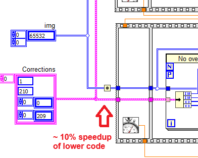

I also noticed that my code is consistently about 10% faster if I insert an "always copy" as shown. Hard to tell what's going on.... or if it is even real. 😄
Message 20 of 23
