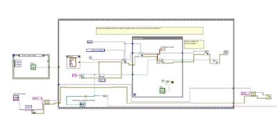

Hi! We have a Labview diagram block that records sound until the stop is pressed and generates a wav file to redirec it to a python program. It then prints back its results. We want to conncet an ESP32 to our labview so that when the user clicks the start button in  the program the ESP32 runs a Mucode wich initializes the counting in a 7 segments display. When the user clicks stop the display stops the cronometer. We have used the VISA selection port but we dont know if our connections are ok... can someone help please?
