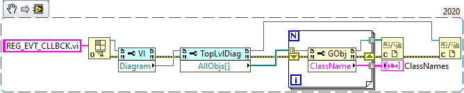

I'm stuck with a generic GrowableFunction (Generic » GObject » Node » GrowableFunction » GrowableFunction). When just getting AllObjs[] from Diagram, this is the type of reference I get for an already existing Register Evetn Callback node on the diagram. I didn't find a way to use this (I guess) too generic level to select a event to register.

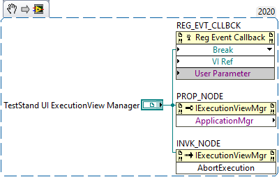

The REG_EVT_CLLBCK.vi diagram looks like this:

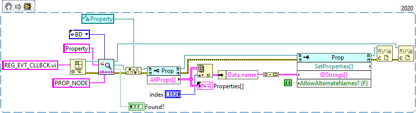

@Mathieu_R. wrote:
Thanks for your answers. I'll "brute force" properties by index... With some luck, I'll find something interesting to get this programmatic event selection done.
Here is what I have on that.
(1,319 Views)
