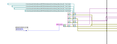

I'm currently working on a project using Vision Builder AI 2023 that requires 4 cameras, each assigned to an independent inspection job (one script per camera).
My goal is to run 4 inspections in parallel, and I'm trying to do this by opening 4 API connections (VBAI Interface) simultaneously from LabVIEW.
However, when I attempt to open all 4 API connections in parallel, LabVIEW freezes or becomes unresponsive.
