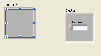

OK, I see that you did not follow my diverging track 🙂
Here is what I am NOW talking about:
this is a LV 8.5 FP and its diagram:
Selecting "Cluster", I created a reference constant (shown below in the middle).
From this constant, I created a "Control": that's "Cluster 2" shown on the diagram below, and on the FP above, after I selected "Show Control".
The control IS NOT SHOWN. And it does not matter that the cluster is a typedef or not (it is not).
So either I don't understand what we have been talking all along (I don't care about the bogus error if NI decides that it does not matter, I really need to move on), or I don't understand what the purpose of "Show Control" in a reference control is supposed to do.
From what I see, it does not work with Clusters. Typedef or not. Is that fine? Fine! Is that not? Fine with me too.

As I said, I don't see anything wrong with what you did.  I have done the same in the past.  Clusters seems to revert down to an empty cluster and any data.  I guess I have never bothered to look at the control in the reference before.
I do typically create it the way I outlined, which is to create a control reference and drag the control type into it, or manually select it from the right-click list if it is a primitive (i.e. boolean, string, etc.).
The (hidden) star is what is important - it indicates that the type of cluster is embedded in the reference.  This means you cannot wire a different cluster type's reference.  If the star is not there, you can wire any cluster to the reference.
