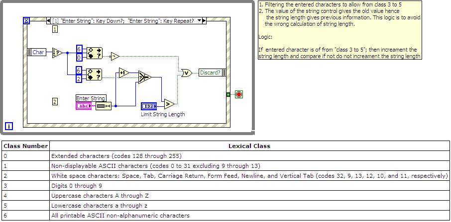

I have got the required functionality after checking out all filtering options. Here is code snippet to understand its functionality and have further developments/modifications as per requirement.
