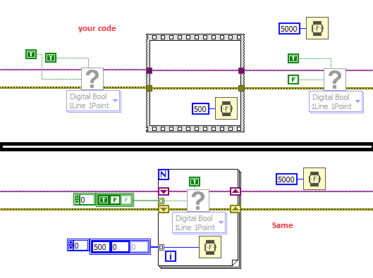

    • Instead of the two writes and the wait, you could use a single write in a FOR loop, autoindexing on a [T,F] array. You could even autoindex on two waits (500ms, 5000ms)

Can you please clarify your last comment:
Is there a way you can explain through code?
There are many variations, depending on how accurate the timing needs to be, but here's a comparison.
