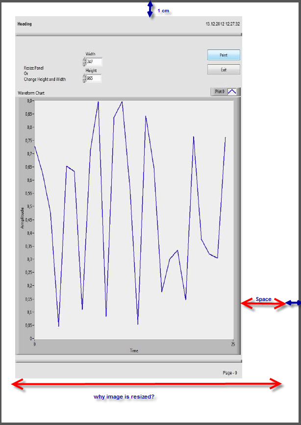

The FP image appended to the report doesn't fit on the page.
i tried changing the Size of the front panel but doesn't help. i hope the default boarder size is 1,1,1,1. please find the attached Vi and report created.
why is it so?

Hi Crossrulz

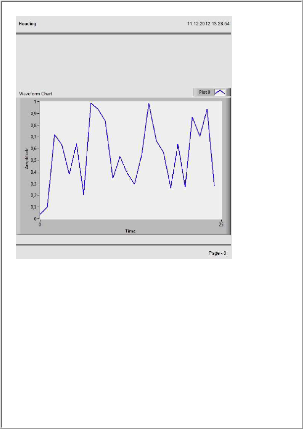

i tried two different FP resolutions. the Vi and results are also attached.
the second pdf is made with resolution width 683 x height 965.
but the image always leaves some space on the right side of the page. And the width of the image in PDF is automatically adjusted.
thanks

Why the image width is resized? the boarder size is 1x1x1x1. Always the image leaves some space on the rightside.

Try to set the alignment to MIDDLE when appending the image.  That should center the picture on the page.

thanks crossrulz.
with a png image format i get better quality prints, but still the quality is poor compared to printing VI frontpanel after execution.

html reports
alignment works only with html reports i think. for that i must have IE installed on my PC isn't it?
also i need to set the margins in IE settings also.
Stadard reports
the image is not fitting on the page if i resize the image. is this a bug?
