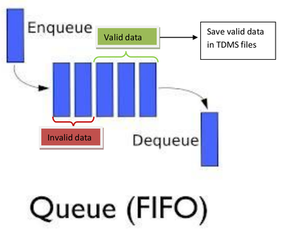

There should be many approaches to solve this issue. However, I think the most recommendable solution will be to use a FIFO queue. Considering that you will be acquiring data for certain amount of time until the readings begin being stable (we don’t know when that is going to happen) is not a good idea to record all the readings (memory considerations). Using a FIFO will allow you to maintain in memory a specified amount of readings. When the FIFO is full, the oldest reading will be discarded.
When you detect the signal from the light curtain, we are supposing that there will be invalid information in the queue. However, you will be able to select just the readings of interest using the array functions.
I found the next example in the community that shows how to use the LabVIEW queue as a FIFO.
