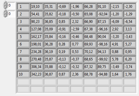

I am having trouble appending table to report. It only appends two or three of ten rows. Problem is that array is always various size. The wire diagram is posted here:
The problem is that it does not append all rows that are actualy in my array but just only few of them. Here is the actual table which I want to append:
And this is what i get in excel worksheet:
You can see that only two of ten rows are in report.

it would be better to delete this thread. the problem was in my template. it was hidden cells in excel that caused me a lot of headache 🙂
