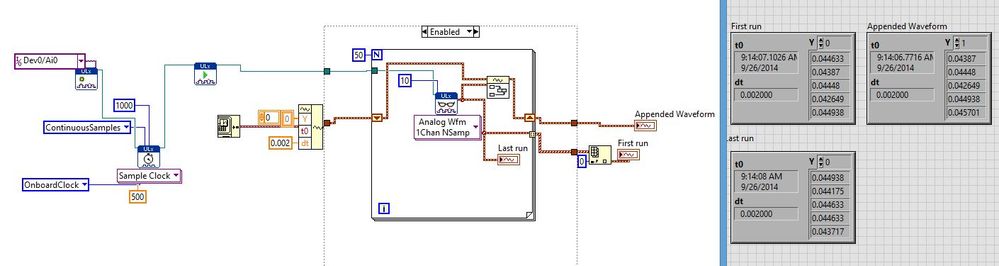

I'm reading from a USB. Here is my attempt to initialize with a t0. As you can see, the t0 for the First run and that of the appended waveform are different. Essentially, I want a true timestamp from each of my samples. The ULx read data maxes at approximately 500 Hz, but can vary fairly significantly. I will need to append several samples to allow realtime calculations. If I drop a few samples because of a lag in read time, that's ok, but I'd like to be able to adjust for that by looking at the timestamp rather than a sample count.
If there is a better way to achieve that, I am certainly open to suggestions.

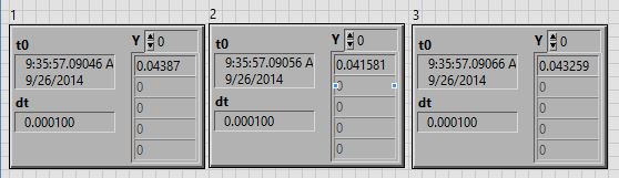

The timestamp comes from the driver (pc time) - not the device. The dt comes from the device.

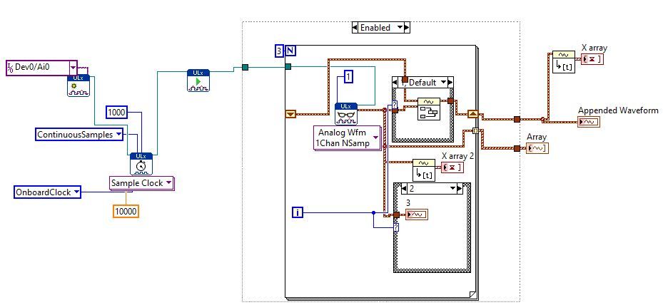

This is what I'm looking at, The results at the bottom are a new indicator from the case structure at the bottom of the diagram:
From each loop:
