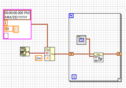

I am using Labview 2014, and have included the .vi and picture.
Message 5 of 28
(7,934 Views)
Here is the picture with timing visible.
Append Waveform
Message 6 of 28
(7,930 Views)
You have an unitialized shift register. That is why you have the default dt of 1.

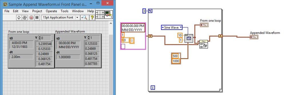

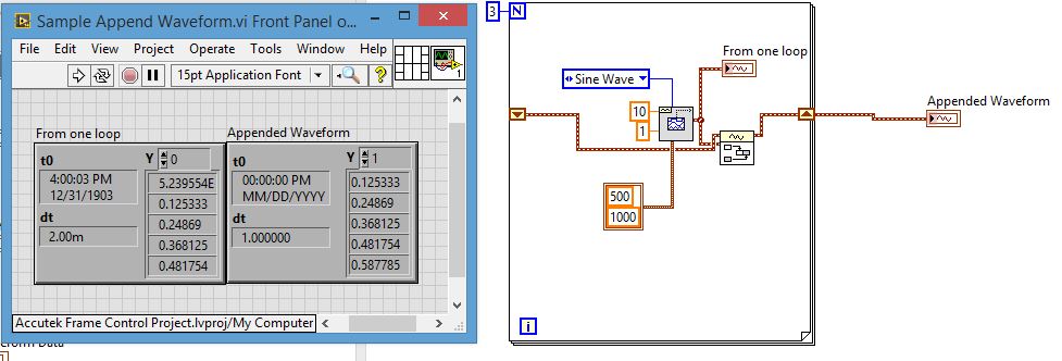

Do I need a seed value for the initialization? A constant doesn't appear to solve the problem. Thank you for your help on this.

I'm hoping to be able to be able to keep the t0 data from the first measurement.
Message 9 of 28
(7,915 Views)
You need the correct dt and t0 in the initalizing constant Leave Y and Attributes empty.  dt and t0 of waveform B are ignored by append waveform and the dt and t0 on the SR will be preserved and propigated through the loop.
