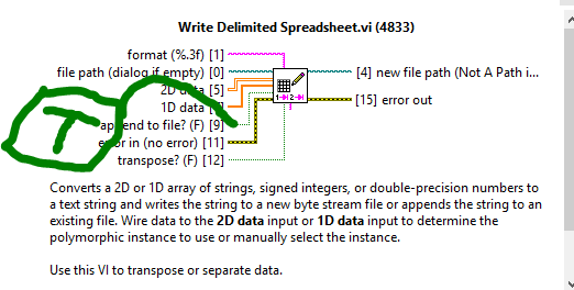

During a reading I need to append data at every new line to a test.csv file. But with my approach (image attached), I am overwriting the file. What should I do?

Add a constant and a wire

Thank you. That was silly of me.

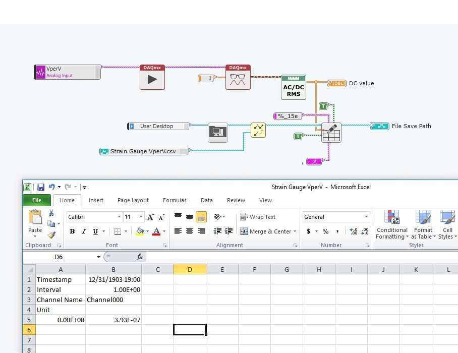

I am having same problem, using DAQExpress, but I do have append file set to "true".  The goal is of my VI is to output the average DC value (ΔV/V using NI9237) of a full bridge strain gauge at known discrete load inputs to ultimately calibrate the full bridge strain gauge.  I run the VI once per load step.  The VI does output to a .csv file but it overwrites the ΔV/V value instead of appending it.  Any suggestions?
