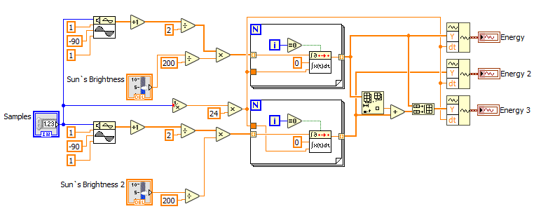

I have an issue with understanding how can I configure append signals. I have 2 waves and I want to see them together one on top of the other. The second wave to start with the maximum amplitude of the first one. How can I do that? I attached a picture:

Hi Davidoff,
you need to set the offset of the 2nd waveform to the end value of the 1st one…

I still have no solution. I attached the vi file bellow.

Hi David,
do as I wrote:
use the last sample of waveform1 as offset for waveform2, then merge them…
