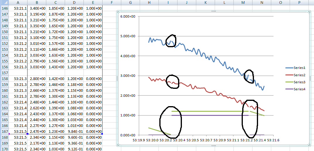

Appended text file in loop adds unwanted delimiter value at end of each iteration.
I am using 'Export To Spreadsheet.vi' in a loop which saves a text file and appends data from a 1D array waveform for each iteration. My problem is that at the end of every iteration an extra delimiter value is appended to the file. When I then attempt to graph my data, I get gaps, as seen below (circled in black).
When I start to analyze the data, I'm sure this will be a nuisance. I can not seem to find a solution to this problem. Any advise would be greatly appreciated.

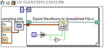

In LV2012, I only see "Export Waveforms To Spreadsheet File.vi". It works ok, here:

Just wire TRUE here 😄

Export Waveforms... does indeed place an end of line at the end of the last line, resulting in a gap when the next batch of data is appended.  I just had the same problem with a VI that a co-worker had written.
It didn't in the snippet I posted above (once I changed "write header" to false). Am I missing something?
