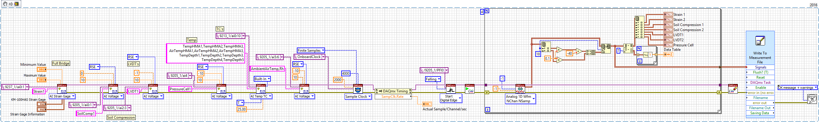

It really depends what you mean by "building". You already have an array of waveforms, so how do you want to append things? Your question is quite ambiguous. One interpertation would be to keep an array with the same number of elements, but to append to each waveform as new data is received. Another option would be to skip the building and write to file at each iteration. So tell us what you have in mind.
In any case, most of your code is extremely convoluted and inefficient. Way too much code! For example the way to scale two of the waveforms and splice out the graphs and table from the array could prpobably be done in a significantly easier way (see image).

Re: More convoluted and needless code:

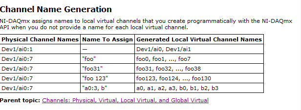

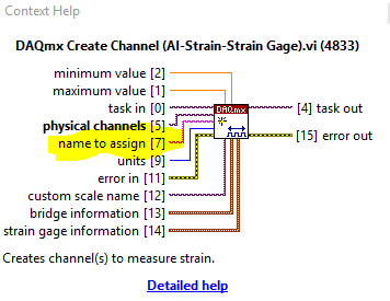

The array functions are inplace anyway and math primitives accept waveforms.  With the DAQmx Create Channel.vi See that "name to assign" input?   Also, do not configure tasks and stop them inside a loop its sort of pointless to stop a finite task after reading it anyhow.
Capture.PNGCapture1.PNGThat gets rid of a lot of junk code
