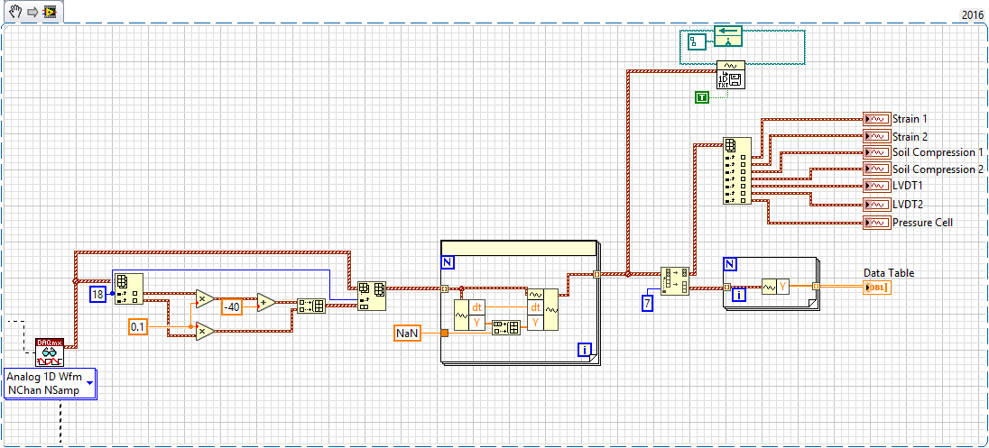

OK the express vi is just not going to handle appending to file with gaps in the times between the end of one triggered sample and start of the next.  There are no really drop-dead simple ways around this.  Appending wafeforms ignores the T0 of the appendant waveform,  Enabling logging in the DAQmx task would help but, graphs would look funky (adding an undesired line segment between triggered reads) and DAQmx logging only supports TDMS format (Although- TDMS is another subject you might want to read up on) .  "Waveform to XY pairs" and "Get Time array from waveform" don't give outputs that play nice with dynamic data (Besides we hate the DDtype anyway right?)
SO!  for your investigative pleasure!
Note: I added a new loop to append a "NaN" value at the end of each channels triggered acquisition.  NaN is not a number.  It has some unusual effects on graphs since it isn't a number it cannot be plotted on a scale that is numeric!  (Hey, that puts the gaps in the graphs between the end of one acquisition and the next trigger!)
Also, I unloaded the express vi in favor of an approach that might be a little more helpful to us in building the desired file.
Enjoy the tour through the help fileSmiley Very Happy
It would be sufficient to unbundle/bundle the Y component since the dt does not change. Even better, use the in place element structure in the loop as in my example.

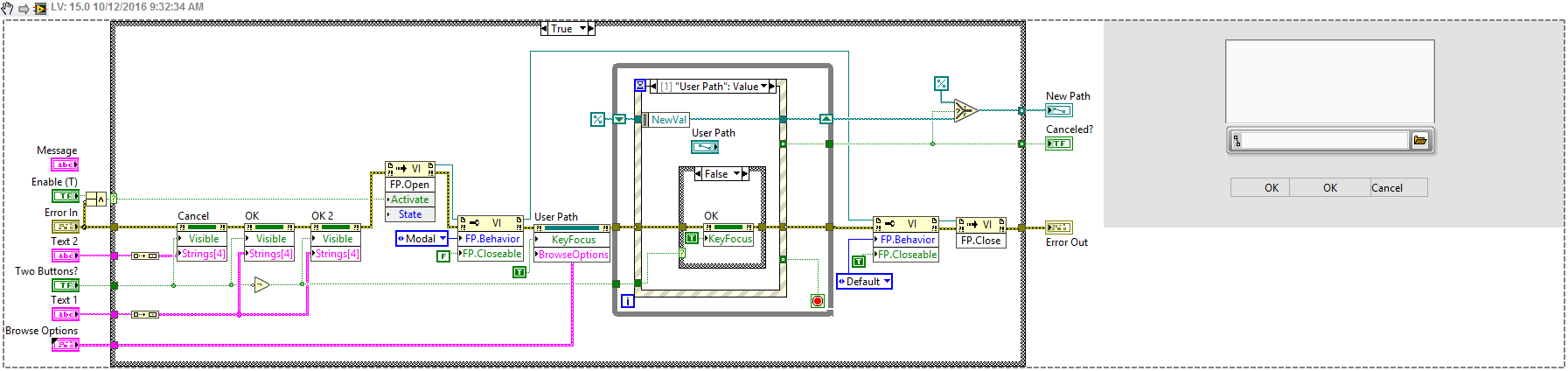

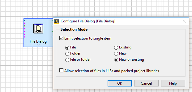

Wiring a blank file path constant to the Feedback node initializer terminal will pause the vi and prompt the user for a file name.  Not exactly desired behavior! you may miss triggers So we need a prompt before the loop.  Right click the feedback node and select "Replace with Shift Register."  Initiallize the Shift Register with the output of a "File Dialog" express vi.
Capture.PNGFile Dialog is actually one of the "Good" express vis.  Many are not so great.  It comes down to scope.  Write to file- is a "Bad guy" because the scope of storing data is vast, selecting a file name and path is much more limited so that express vi is closer to bulletproof.  Of course, since I persoally don't like some of the core vis under the file dialod express vi  AND I don't normally support localization (changing the language of displayed text elements) I use this baby:
Honestly I chose the FBN (Feedback Node) instead of the SR(Shift Register) simply because it fit in the screen where the SR loop terminals would have been out of view.
