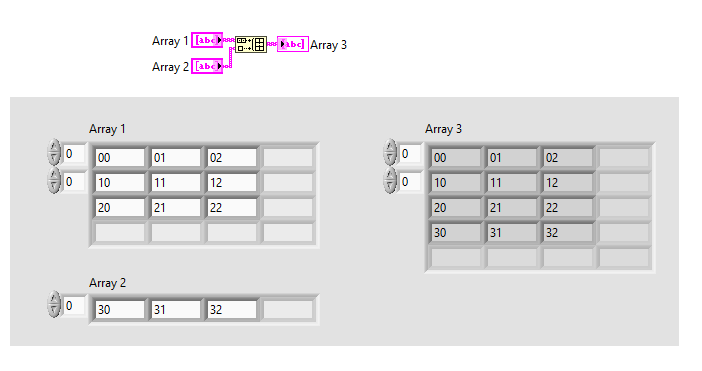

"I would just like to be able to insert a new value at the end of different columns"
This would just be adding a row. You can use "build array" for that.
The OP never really talked about rows. There is no way to make sense of the jumble of "different column", "specified column", "append", "insert", "replace" (in the file name), etc.
Of course anything can be inserted anywhere, it is just a matter of padding first. 😉
(5,151 Views)
This helped me because I realized I can just pad zeros to get to the end of the column I want but you have to insert stuff into those other rows. I used build array.
