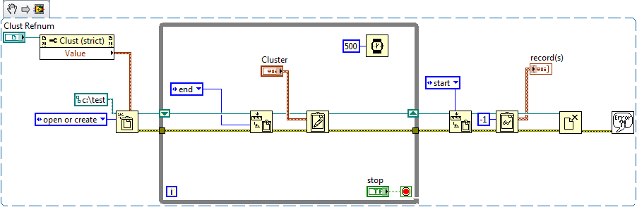

If you want to "append" data to a datalog, you have to set the file position of the datalog. In your current code, you are writing the the beginning of the file each time by default. Take a look at the example below. When the data is read at the end, it is returned as an array of clusters.You will also notice that I set the datalog position once again after the loop to make sure that the read operation reads the entire file from the beginning.
-Zach
