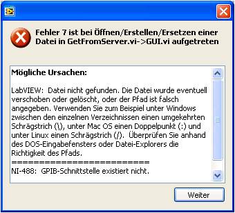

I'm using LV 8.6 and Application Builder. My Labview vi uses some third party vi's to control a linear motor. The vi works fine un-complied. I can complie an exe without errors but when I run the exe, (on the same PC) I get the error shown below. (Connect.vi is the third party vi used to start communication with the motor.) This happens with my vi and example vi's from the third party. I also have a exe of one of the vi's from the motor supplier which works.
On the error, I'm not sure why it mentions NI-488, I've never used that (I don't think) so why is it causing an error?

I get a similar error, with the same behavior (works as a VI but not as an exe). My problem is related with file open/create. As a VI the program is able to create a new file, but as an EXE it's not. Also, when a path to an ini file (or some other type of file) is not valid I also get this error.
My advice is to search for some file (ini, activex -ocx, and so on) path that could be no more valid or for something like this. Can you make a screen-shot with the property node + the inputs type that generates the error. Maybe it will give us a hint.

Thanks for your help. I think you're right about something missing. I'm not sure I understand about the property node. I've made a simple vi just with connect.vi and an error out indicator that when complied just gives the same error, code 4, source: Property Node in Connect.vi- >Connect_exe.vi
