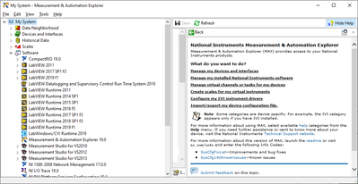

If there is MAX installed on both machines, compare the list under the MAX node "Software" and try to guess if any component is missing.
Paolo

Glad to hear you found a workaround.
With MAX I meant the NI Measurement & Automation Explorer, which is often installed together with NI device drivers:
Paolo
