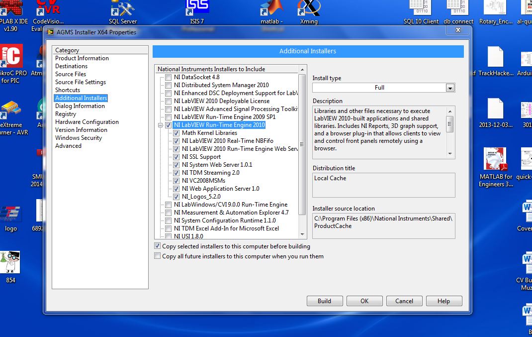

But I am assuming that when I make the installer, the 32-bit Run Time Engine is appened with the installer, as show below
Since from the picture you can see its including the support installers from '\Program Files (x86)\'

I know and I fully understand what you are saying, but would my LabView, by default would be including a 32-bit RTE when I make the installer?
I think it is, because I tried my installer on two more machine just now, both 32 bits. One Dell desktop Intel Core 2 Duo, 2GHz, 1.5GB RAM and Windows 7 32bit
and anohter IBM Thinkpad 510, Intel Centrino running Windows XP SP3 32bit - and it the installer works fine on those.
So I am guessing that when I make the installer it does include 32-bit RTE but not 64bit RTE.
but then again it should not matter since WoW64 takes care of running 32bit applications on 64bit machines.
There must be something very basic that I am missing.
