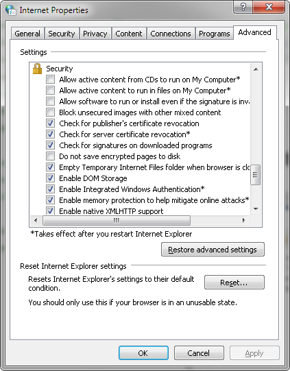

I've had this exact issue on a computer that couldn't access the network.
It is because .NET is trying to access the network. Can you run this application on a computer connected to internet ? I believe you have to uncheck some options
Control Panel --> Internet options --> Advanced
I believe the three I unchecked were: "Check for Publisher's certificate revocation", "Enable Integrated Windows Authentication", and "Check for Server certificate revocation". I am not sure about the exact 3 I unchecked, but give it a try. Good luck !

Thanks.  I don't think I would have ever figured this out on my own.
