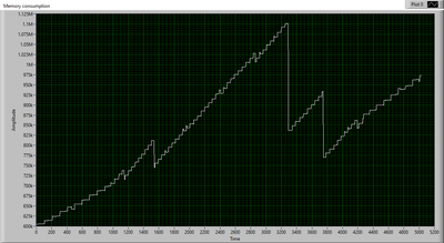

The problem also affects the uncompiled code. The graph attached is made while I run the labview source code, in this case I measured the memory consumption of the LabVIEW.exe. There are these weird drops in the graph which I really cant explain as the application was idling and there were no user interaction of an kind. (I did not wait for reaching the 3G limit but the trend is clearly visible.)

Thanks everbody for responding. I didnt pay too much of an attention of how the graph looks like I just considered that the memory need is increasing. But if you look carefully its stairstepping. The steps take about 90 samples and as the query was made in about every 300ms one flat region lasts for about 30s and then increases.
The modules I disabled take action in every 30s so I'm about 99.43% sure that they are responsible for the issue and I'm also almost positive that somewhere - over the rainbow - I forgot to close at least one reference. I will investigate this issue later, and as mentioned I will post it on the DQMH forums.
