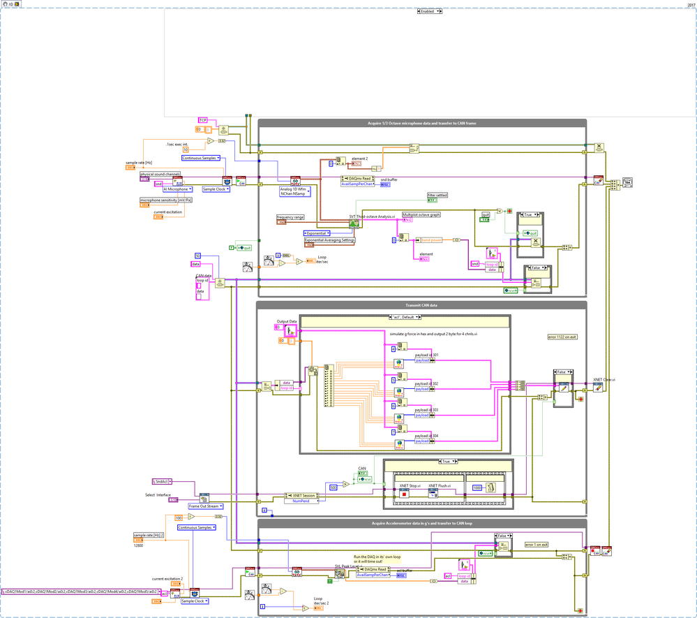

CODE DEPICTED BELOW:
RUN ON EMBEDDED LINUX STOPS FOR NO APPARENT REASONRUN ON EMBEDDED LINUX STOPS FOR NO APPARENT REASON

Accepted by topic author sfrosty
Maybe the TCP queue in the top loop is the problem.  You have the dequeue disabled so data just keeps building up.
aputman
Message 9 of 12
(6,233 Views)
Wow! Great Catch! I disabled and deployed. It appears the program is consistent in that it times out in about 1/2 hr. I'll see if it's still running Tue morning. If not I'll redo without TCP loop.
Renaming to short filename "Linux.vi" had no affect!
Thanks Again!!!!! Smiley Happy
