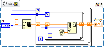

As Patryk said, you replace individual Array Elements.  Here's an example.  Note that the entire Array is maintained in the Shift Registers.
How fast is this?  If N = 2000, so I'm generating a fairly large 2D array, it takes 122 milliseconds.  If I do it the "old-fashioned" way, and just have two For Loops with a single Random Number in the inner one, brought out by two Indexing Terminals, it takes 155 milliseconds.  I didn't time it with appending elements to the Array, but I'm sure it is much slower.

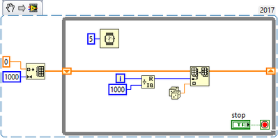

EDIT: I saw that Bob already provided nice example after I posted mine. What I can add is that with While Loop you can use Quotient&Reminder to get proper index number in case of overwriting array elements.
