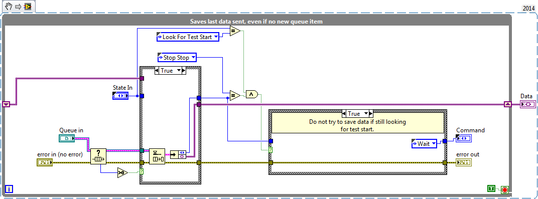

Just my two cents...
One of my favorite architectures is using a state machine with a queue interrupt.  Each loop iteration it checks the queue looking if something needs to be dequeued.  If it does, the queue state supersedes the current state - if not the state machine continues as normal.
Message 14 of 20
(2,679 Views)

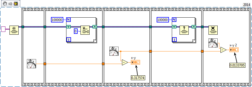

@RavensFan wrote:
Any reason not to just use a Dequeue element with a zero timeout value?  If the Dequeue time out, then you know the queue was empty.
I originally used it in a control loop where timing was critical, and have since just copied the code.  Dequeue is about an order of magnitude slower than obtain queue status.  Both are very fast and it likely didn't make a difference, but....
Message 16 of 20
(2,632 Views)
Very interesting.  I wouldn't have expected that.
Message 17 of 20
(2,621 Views)
You need to wire the output of the queue status. It may be optimised away otherwise.
Message 18 of 20
(2,615 Views)
I thought of that too.  So I added indicators on the Timeout terminal of the Dequeue, and the #pending remove terminal on the status.  Results were very similar both in actual value and ratio between the two examples.
If there is anything else missing in the benchmarking example, I can't find it.
Message 19 of 20
(2,606 Views)
Yup, just got the same results here.  Go figure.  That's news for me and it's a big enough difference to definitely remember for the future. Smiley Happy
