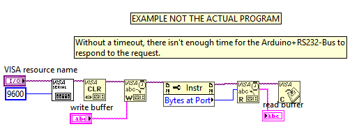

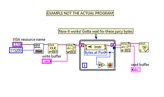

And voila! It always responses. Then it finally clicked. Right after I sended a request I just tried to read the buffer. But it takes a bit of time for the Arduino to respond.
SOLUTION
The fault lied here:
The faulty versionThe faulty versionThe workin versionThe workin version
 So all in all it was my fault. Sorry to bother y'all!
Thanks for your time, have a great day my friends.

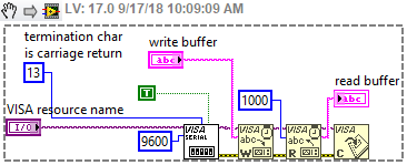

What you show is not a solution.
The problem is that you are using Bytes at Port which is the wrong thing to use 99% of the time.  Even your "working" program will break if the while loop stops once it receives only 2 of let's say 5 bytes in your message, because you are set to read only the number of bytes that it saw when it first detected there were more than 0 bytes.
The correct solution is to use the termination character.  When you use println, you are sending a carriage return.  So set your LabVIEW code with the VISA Serial configure to have the termination character enabled and be a carriage return.  By default, what you have now when nothing is wired in is that it is enabled and is a linefeed character.  So you need to wire a decimal 13 into the termination character input if it happens to be a carriage return.  Then you will just read a sufficiently large number of bytes that is higher than your longest message.
 Example_VI_BDExample_VI_BD

1. You might want to consider using the Serial.readStringUntil() function in your Arduino code, which will simplify things.
2. DO NOT USE THE BYTES AT PORT!!!!!!!!!!!!!!!!!!!!!!!!!!!!!!!!!!!!!!!!!!!!!!!!!!!!!!!!!!!!!!!!!!!!!!!!!!!!!!!!!!!!!!!!!
As has already been stated, your Arduino is using the PrintLn command.  This means it adds a Carriage Return (0xD, CR) and a Line Feed (0xA, LF) to the end of the message.  So all you need to do is enable the termination character and set it to the Line Feed (both defaults on the VISA Configure Serial Port).  Then you just tell the VISA Read to read more bytes than you ever expect in a message (I like to use 50) and the VISA Read will wait until it reads that termination character, it reads the number of bytes you tell it (again, set the number of bytes to be larger than any message will be), or you get a timeout.
So from RavensFan's code, I would just delete the constants on the top of the VISA Configure Serial Port and it will work just fine.
