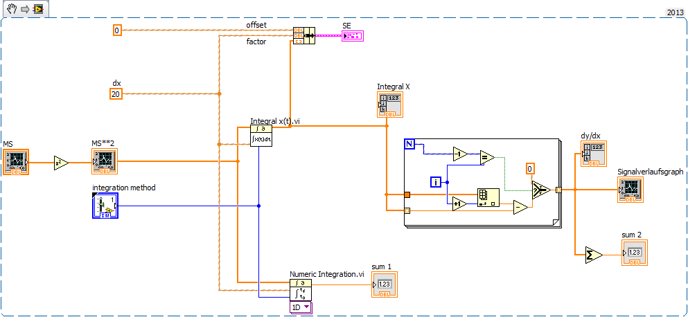

hi vgrchada,
Regarding your other posts on this topic, it appears to me like you're not happy with the output of "integral x(t).vi", which results in a cumulative distribution function.
Have you tried 1d numeric integration.vi instead?
Here's what I have in mind
Alex
Message 14 of 31
(1,911 Views)

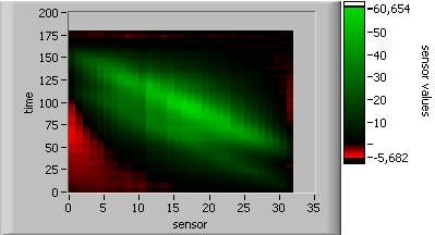

Let's look at your input data, which is shown in "Strain and time data" Array from "trial 1 case B.xlsx":
There are 32 sensors lined up. Between every sensor, theres the same distance (x-axis).
Your sensors produced values in a range between -5,6 to +60,6 (z-axis, intensity) every 0,01 second respectively 100 hz (y-axis).
Now, you want to integrate the produced values from sensor 1 to 32 (x-axis, row), right?
How do you take time (y-axis, column) into consideration?
At the moment, you do a FFT of each column and extract the maximum amplitude (real part) of each column.
How's that related to the graph plotted in photo (4).JPG?
Does every peak in photo (4).JPG represent a sensor/column?
Alex
