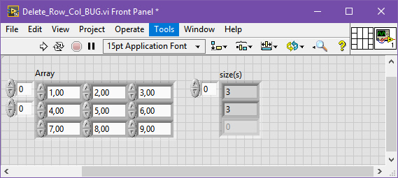

I haven't dug into this deeper but here's what I just saw (it's kinda odd). Say, we have some numeric array of 3 x 3 sizes.
FP 1

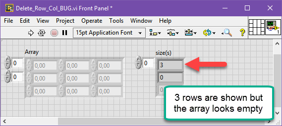

Now we start deleting row or column with this menu item: RMB -> Data Operations -> Delete Row (or Column). Keep deleting until the array becomes visually empty. Okay, now run the program. We see something strange - the array has rows (or columns) completely deleted but columns (or rows) are still here!
FP 2
Is this an expected behavior of this menu items?

Not a bug.  Here is one such discussion on the subject.
https://forums.ni.com/t5/LabVIEW/Array-size-of-empty-array-bug/td-p/3340065
It has some really small edge cases where you might do something like index into two for loops and want it to run 3 times once for each row, and then the inner loop run 0 times for each column.

Really strange! I have no idea. But I will keep in mind, that I must use the "Empty array" from the right click menu, this one really deletes all contents. I mean makes the size of the array zero in both directions. Since there is no element...
I think this is a bug, try it, if you select 3 times the Delete Row, and 3 times the delete Column, only then, the array gets empty!
