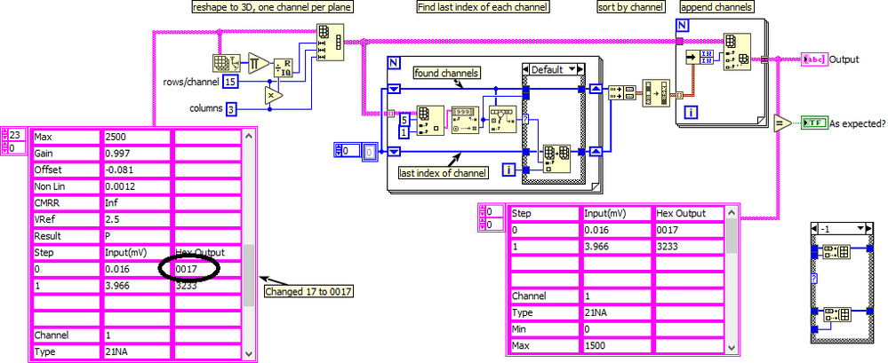

The problem with your desired output is that hex "0017" does not even occur in the input, there is just "17". These are different using string comparisons, of course.
If I correct the input to 0017, here's one possibility:
(See if it makes sense. I am sure it can be simplified further. There are many ways to do this. We also assume that the input is clean, else some sanity checks are needed)

My example above should do exactly all that.

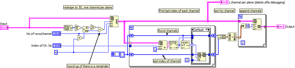

Functionality is Fine.
Few bugs are there if i try to change the follwing items :
1) No. of Rows per channel data as  control variable (19 instead of 1)
2) Index value for finding the channel number as control variable (6 instead of 5),
i will sortout the bu and update the working code for your reference.
Thanks a lot.

When i try to change number of rows per channel, the following issues were found
1)Sorting is not in prober
2)Array Size is Changed
3)Few Channel Elements are deleted
Note: I assumed No.of rows/channel is 19 and Index of Channel Number is 5
 I attached Data, Code and Snippet for your reference
Message 7 of 8
(3,656 Views)
  • You have 21 (not 19!) rows per channels (and missing two empty rows at the end of the input). For that reason, we should round up so the last reading is not truncated.
  • Your index control belongs before the loop. It should not be changed during the run and all results would be random once you would. The compiled code is much more efficient if the control does not need to be read with each iteration but can be constant folded during the loop.
