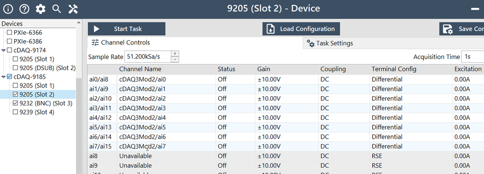

Use a State Machine for your code as suggested. The 9205 has differential and SE inputs, if you use differential inputs, then you are using two of you analog inputs for a measurement. Be aware of that. Below is State Machine that does something similar to what you want, you can use it for ideas. (It is nothing more than a JKI State Machine) Sorry cannot share company code.
