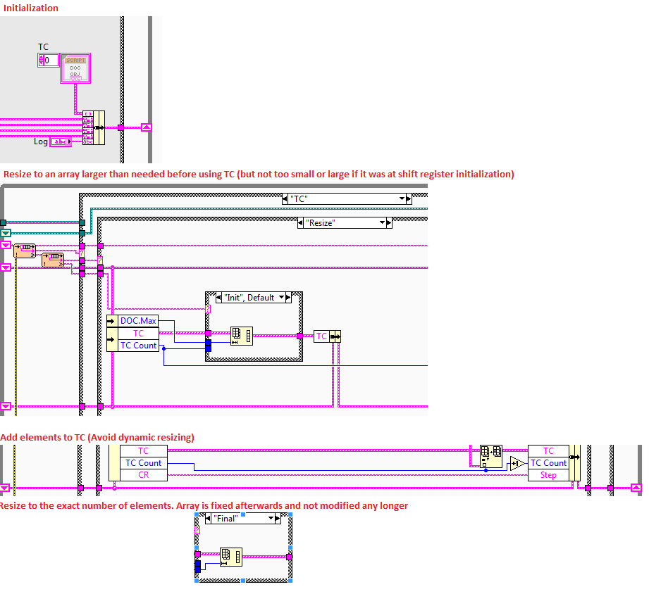

Here's the operations that I do on the TC array.
I did try to have a full size initialization at TC (and disable the "TC >> Resize >> Init"), but that didn't change the behavior.

The compiler is usually very smart, but this might somehow be a fringe case in which it gets fooled and always performs data copies, and with the sequence it realizes it doesn't have to.
For comparison you can try adding an In Place structure, it should also prevent data copies, it'd be interesting to compare the results.
This reminds of another thread a year or two ago, it also revolved around an array of clusters and performance and my suggestion of IPS increased the performance 100-fold. I wonder if we're on to something.
If there's anyone knowledgable about the inner workings of LV (AQ?), if an array of clusters including strings gets a data copy all the members get a copy and a separate malloc (or similar), right? (since each string is just a pointer in the cluster) So if a cluster has 5 strings you'll get 5 mallocs for the strings, per array element ... that adds up quickly.

Looking at your first picture some more, since you have a Bundle you'll probably get a data copy, if you disable that temporarily and/or send that info to a new Event case i'm betting on good speed.
