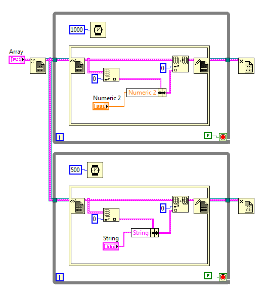

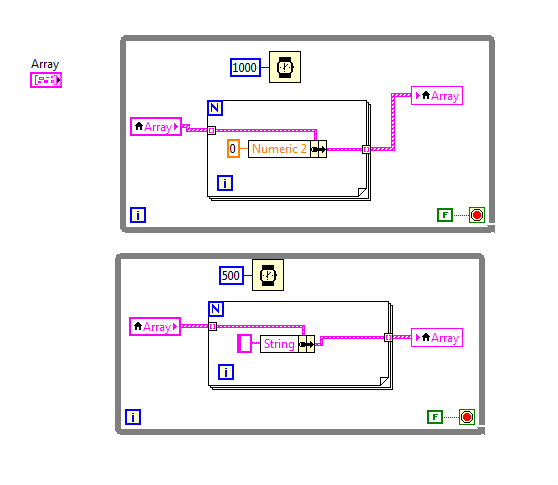

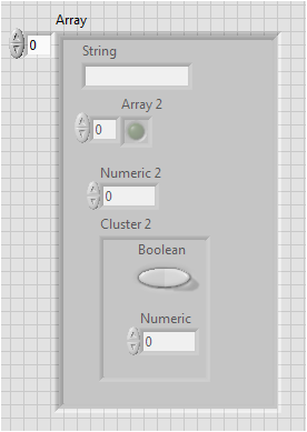

I have an array of clusters, the clusters has others arrays and controls.
 I want to access to each control individually  in the array, in multiple loops to avoid data loosing. i know i can make a reference for each control in the cluster and change his values, but it changes the values in the array too.
Or i can access to the cluster i want in the array, but i cant access each control individually.
If i do something like this im going to loose data.
So what i can do?. what is the most efficient way to do it?
Thanks in advance.

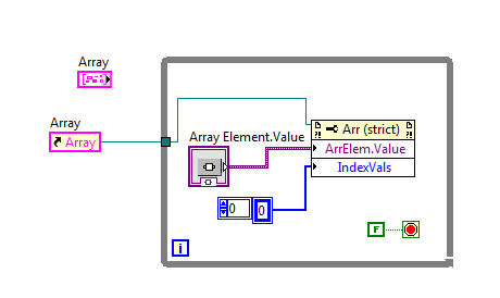

Sounds like what you really need is a Data Value Reference on the array.  Then you use the In Place Element Structure to access the array, index the element you want, then unbundle by name to get the actual control you want.  Do the reverse to clean it up and save the data.
Yes, due to race conditions because of local variable overuse…

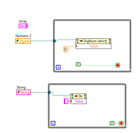

Hi crossrulz, i investigated in place etructures and data value reference, i did some test with this
it seems to work, the only thing is that the control is not updated in front panel, but for my aplication i dont need that, im going to start
testing this option, it seems very good and efficient
