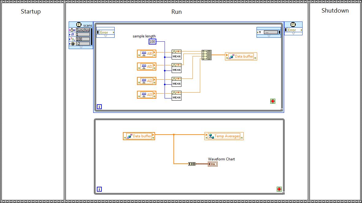

Also in the below photo at the left frame flat structure  they add shared variabled called loop comm  which is not in the project
any explaination?
any explaination?
It is in the project under the library RTComm.lvlib under the RT target.

It was named "Data Buffer " not "comm Loop" as below - please check

I saw it in the project in the "Scan Mode" directory in the download from the page you linked to.
How did you get that image if you didn't download the code?
(4,979 Views)
It is very simple
I did not download the code
I build it following the steps
in the pdf file
I copied the photo from the browser
Now \I downloaded the code and I have seen it
It means it needs to be corrected in the tutorial pdf
