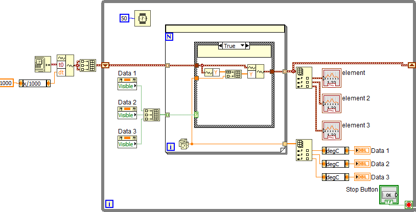

As a new Labview Member, I wanted to optimise my code. For that, I needed to loop the code bellow. I though that the code would give me 3 arrays, each for a loop, but for now, it only updates the same array. So, do I have a problem with my code or it isn't achievable that way ?
Yes, as there is only one array, stored in the feedback node…
What exactly do you want to achieve?
What do you want to optimize?

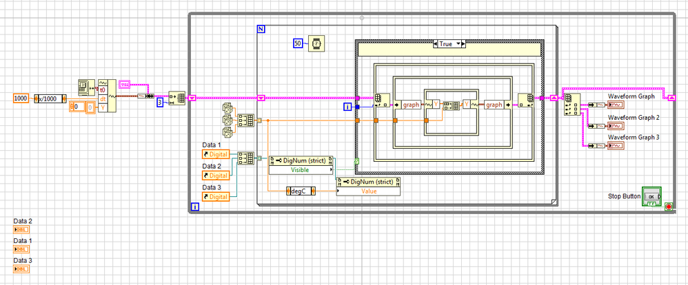

I think that this would help.

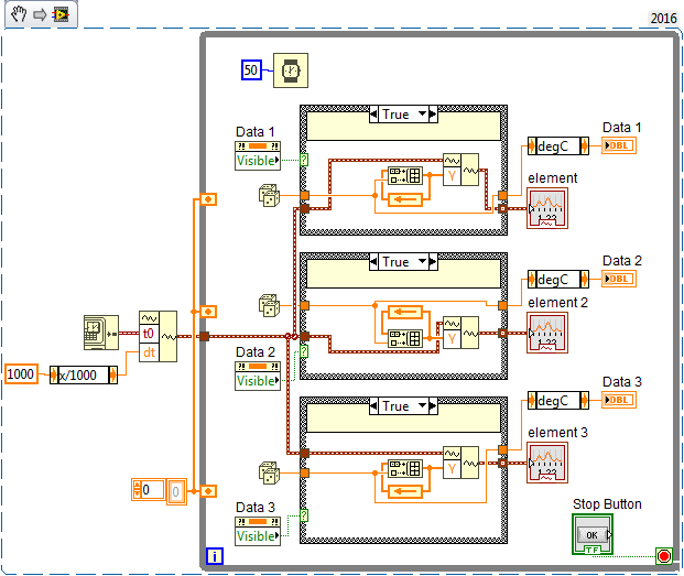

Okay, so here my 'before' code.
It Initialise, read data, and store it in the feedback for each data.
I wanted to regroup the code in a loop, so it would be easier to modify and to read.
But i need it to stay that each data has her own waveform chart.
So I wanted to use the loop, and keep the feedback for each.

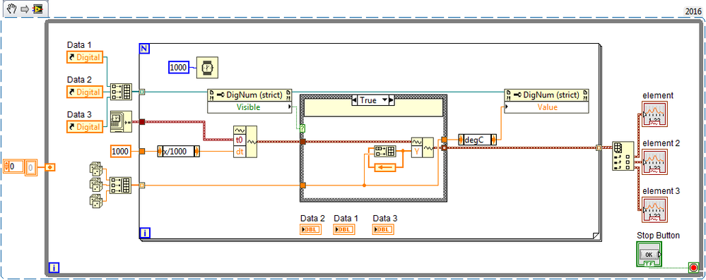

Hi Staken,
I couldn't find the function you use to convert the waveform to the string.
That's not a string, it's a cluster.
(No idea what it's good for in this special application - the waveforms itself consist of clusters…)
See this:
