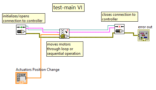

I'm developing a subVI to control 4 actuators through a controller. I've tried two versions, one where a "MoveMotor" VI runs in a for loop, indices feeding into the motor #. Another version where four "MoveMotor" VI's are connected sequentially with indices connected separately. Either of these subVI's is deployed in a test-main VI. In the test main-VI, both of them operate as intended in "run continuously" mode, moving each and every motor sequentially. But when I run the test-main VI in regular "run" mode, only the first motor moves, then the run ends. Another funny thing is, if I set "Highlight Execution" and "Retain Wire Values" in the subVI, then do a regular run in the test-main VI, the subVI functions as intended, moving all motors.

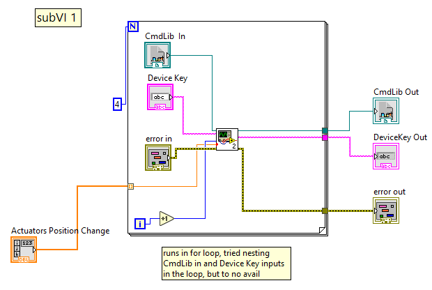

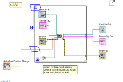

The main issue is that I need to deploy this subVI in a larger project, and it appears to behave same in the main VI of that project, which is why I created a simpler test-main VI to test it. I've found a similar problem in this forum, where a for loop is connected to multiple wires, in which case runs only the smallest number of times. I've tried removing all other wires on the for loop by nesting the input controls inside of it, but didn't solve the problem. I was hoping anyone could defog a little of my ignorance, thanks in advance! (I attach pics below)
Edit: I've attached the test-main VI and the two sub-VI's for reference.
test-main VItest-main VIsub-VI 1sub-VI 1sub-VI 2sub-VI 2

On a side note, it is pretty useless to attach code pictures instead of the actual VIs, especially since you don't say where subVI1 and subVI2 are located. Having a subVI with a "2" on the icon does not help either. That one seems to be subVI 3 that you don't show at all.
There are serious flaws overall, for example all subVI terminal belong on the toplevel diagram and not inside the loop. "Index array" is resizeable, right? You should not wire N if you are autoindexing and the array is of the correct size.
This isn't a problem, but just how LabVIEW behaves:
Your N is wired up as a 4, meaning the for loop will only ever run at max 4 times. So now LabVIEW has to decide, should I run 4x, or should I run the size of the Actuators Position Change array size. It will pick the smallest number. Your Error In, Device Key and CmdLib do not need to be in the for loop. Since they are not arrays, they have no effect on how many loops are run.
