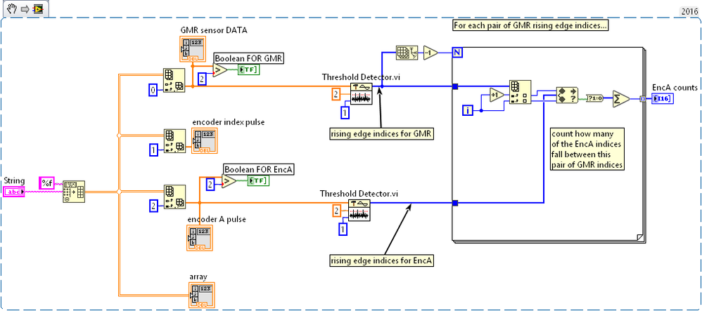

Below is one of many possible ways to approach this.  I first used the built-in Threshold Detector function to find indices for rising edge transitions of both GMR and EncA.  Then for each pair of consec GMR edges, I counted the # EncA rising edges.
The "In Range and Coerce" function returns True only for EncA indices that are between the pair of GMR indices.  The "Bool to 0,1" function converts from T/F to 1/0.  And the Summation function gives me a count of those EncA indices.
There are many other ways to do this post-processing, some of which will be more flexible if you need to consider falling edges, etc.
-Kevin P
