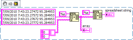

Hi Emike,
for me this works:

Do you have a screen shot of your code? I took the arry that you gave and I can get it to export with no problems.

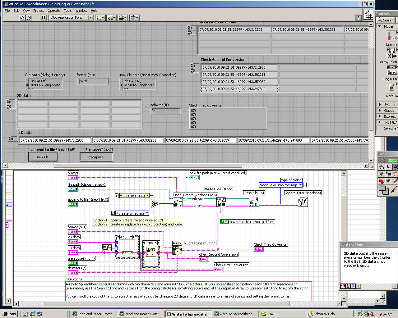

Here is the screenshot. The GUI is in the upper portion of the screen so you can see what the outputs are.18477iE318314CDAD3B4FF Thanks.

Hi Emike,
again no problem:

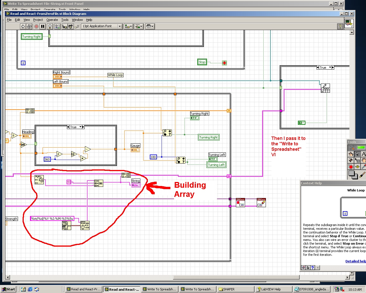

I'm still having an issue. I am thinking it might be in the way I am building my array that I pass to the Write to Spreadsheet VI. Here is a screen shot of the code that builds the array.

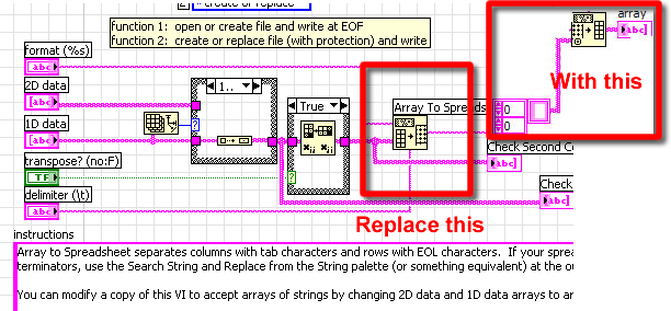

That function you suggest take a spreadsheet string and converts it to an array. But my data is already in an array form and I need it in a spreadsheet string form. When I tried it, I get terminal source compatibility issues.

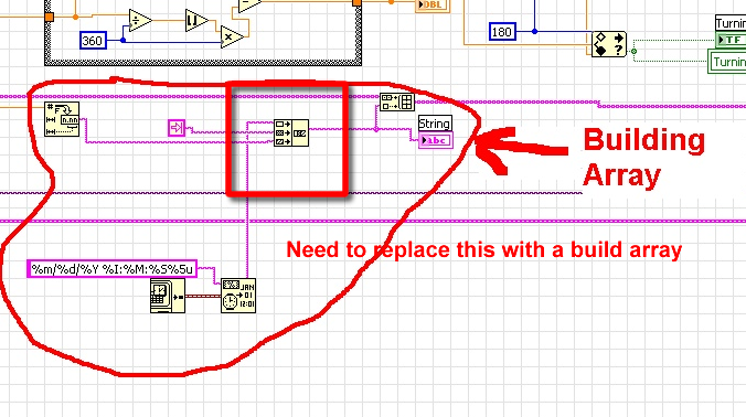

You are building a string not an array. You need to replace the concatinate string with a buil array and get a 2D array not a string for this to work properly.
18487iAC66B1AB8EE3A4E2
