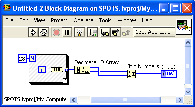

Something like this?

Brilliant! Works like a charm!
Thanks!
